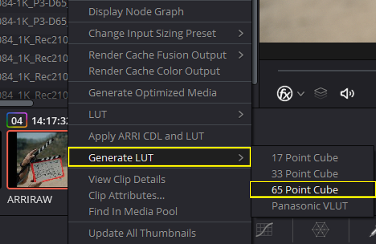

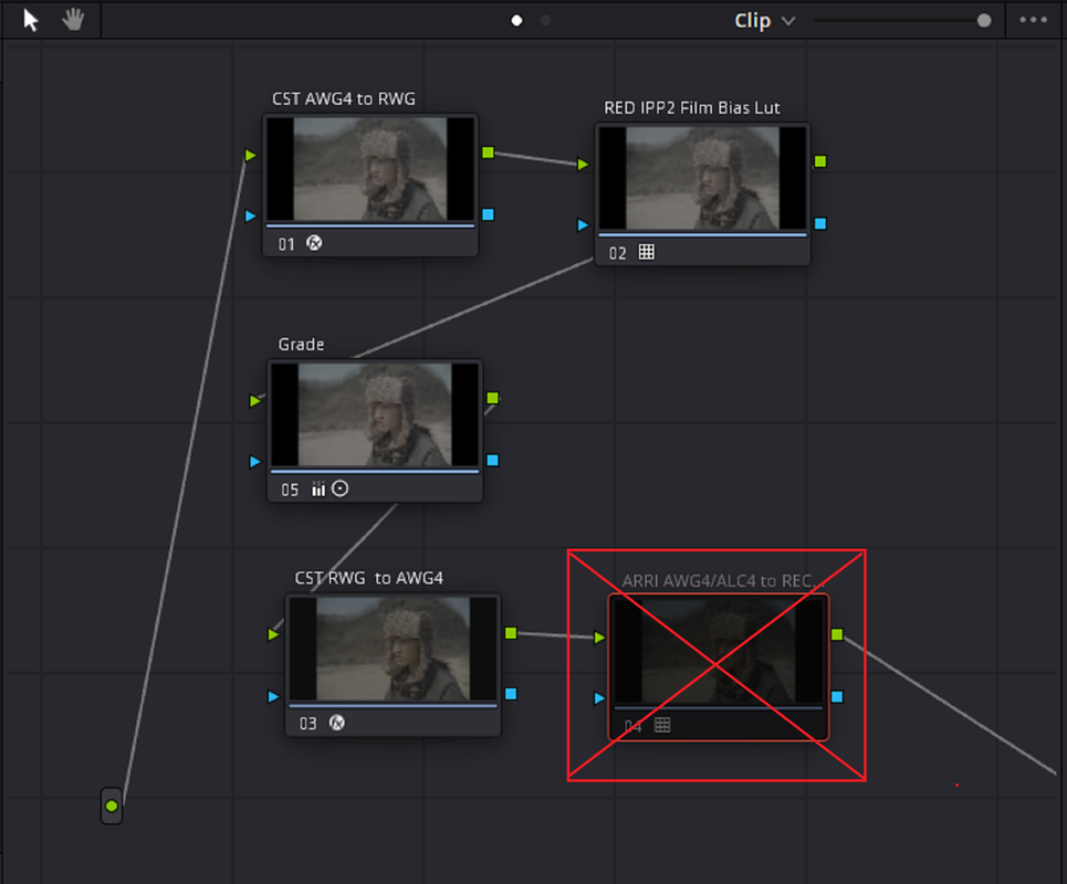

Here's probably the last example I will give which will use the Davinci Wide Gamut COLOR SPACE to create an ALF4 file from, again I won't go through the complete process as before just the difference between the others. In this Example I will use a DCTL(DaVinci Colorspace Transform Language) which can't be made into a LUT with the "GENERATE LUT" menu Item. You can Use a "HALD" file to record any grading function and then use another program to create a Lut from this HALD file, however I won't show that procedure in this tutorial just the resulting Lut.
Continued in next post.......
Nephalem
Posts: 48
Joined: Wed Nov 30, 2022 7:03 am
Continued..........

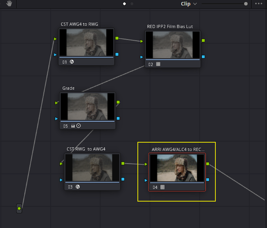

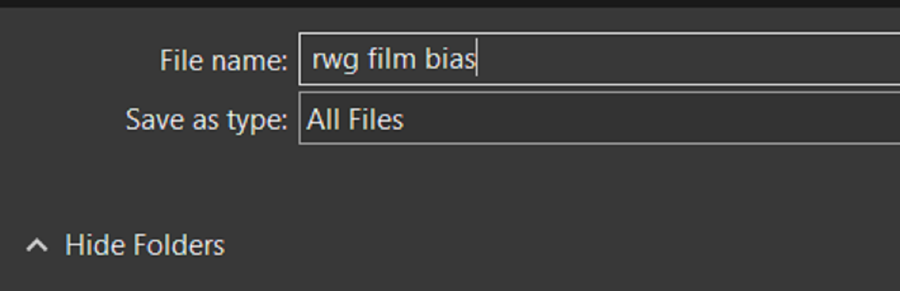

Below is the Lut I created from applying the grade from the RAVENGRADE DCTL to a HALD file then using "3DLut Creator Pro to turn that Applied grade from the HALD file into a Lut
I then replace the RAVENGRADE DCTL Grade with the LUT created from the HALD File with 3DLut Creator Pro

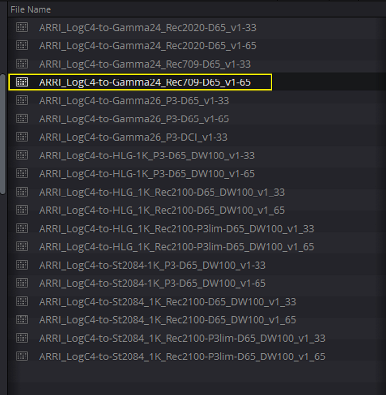

Now I keep the RAVENGRADE DCTL GRADE "Disabled" and I also "Disable" the ARRI AWG4/ALC4 to REC709 Transform Lut as well then Export the remaining Node Grades as a Lut to use in the ARRi Reference Tool

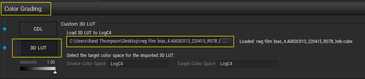

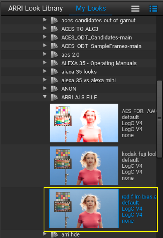

In the ARRI REFERENCE TOOL
Continued in Next Post.....
